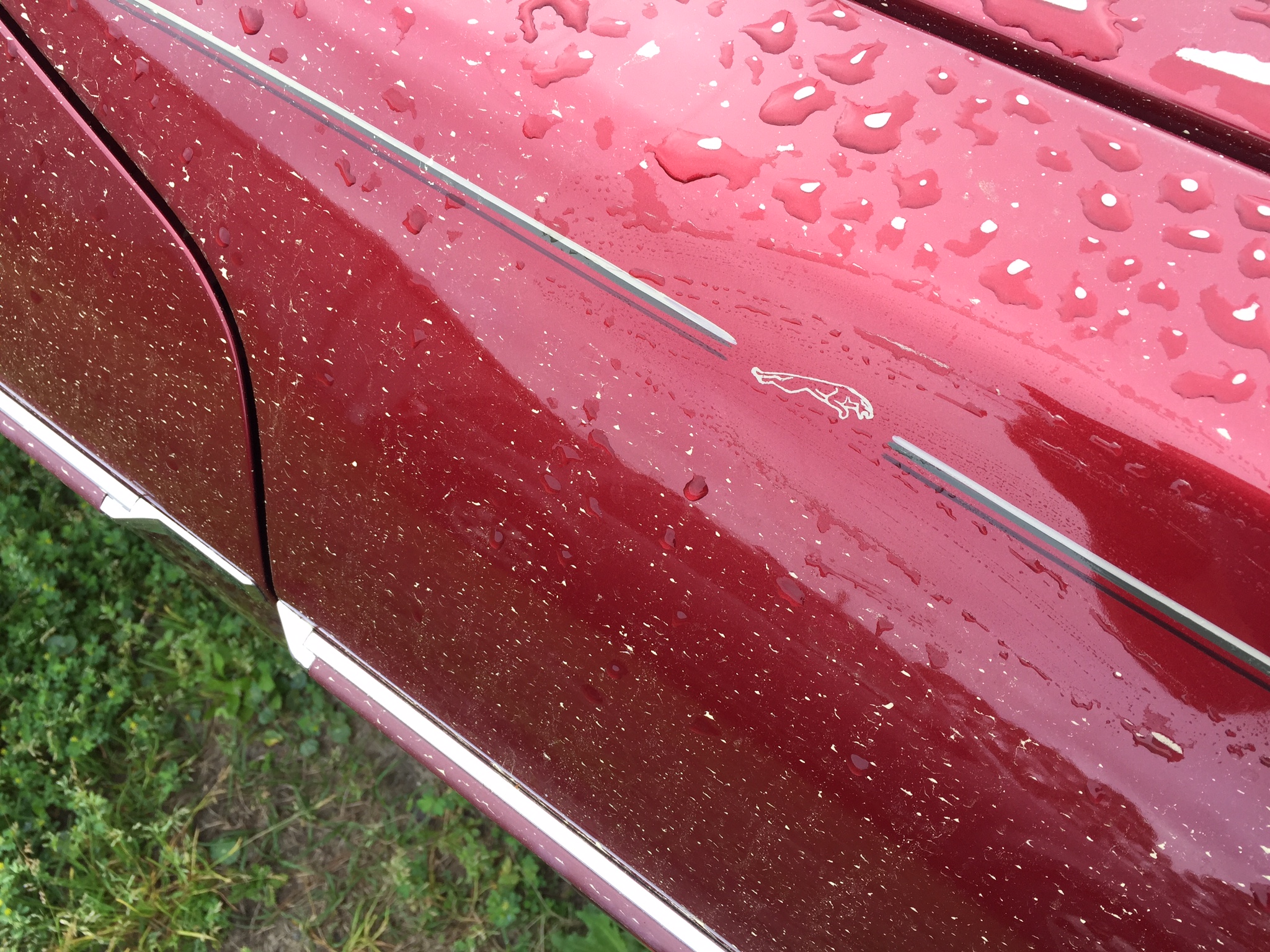

My stripes are 2-tone and run the length of the car high on the fenders & doors (3 pieces per side – front wing, door, and rear wing). The front wings have a pin striped Jag leaper between the front wheel and door. I’m guessing they are factory because of the imbedded leaper but I’m not an expert.
Here’s my concern… Does anyone know if the BEC1917x family of stripes is high-mounted with leaper? I ask because Jaguar Heritage lists 2 part number for the front wing (possible mid-mounted stripe split by wheel well?)

Steve... Thanks for your input... Attached are some equally poor pics of my pin striped. leaper image on front wing. After closer examination lines appear to be painted and the body shop is fairly certain the leaper was done as a paint stamp!
My example is more likely dealer installed or custom, not taped as the factory coach lines would be. So I think I've answered my own question as to factory original or not. And since I'm not doing a full respray the shop will try to preserve the leaper image and restore painted lines as needed.
